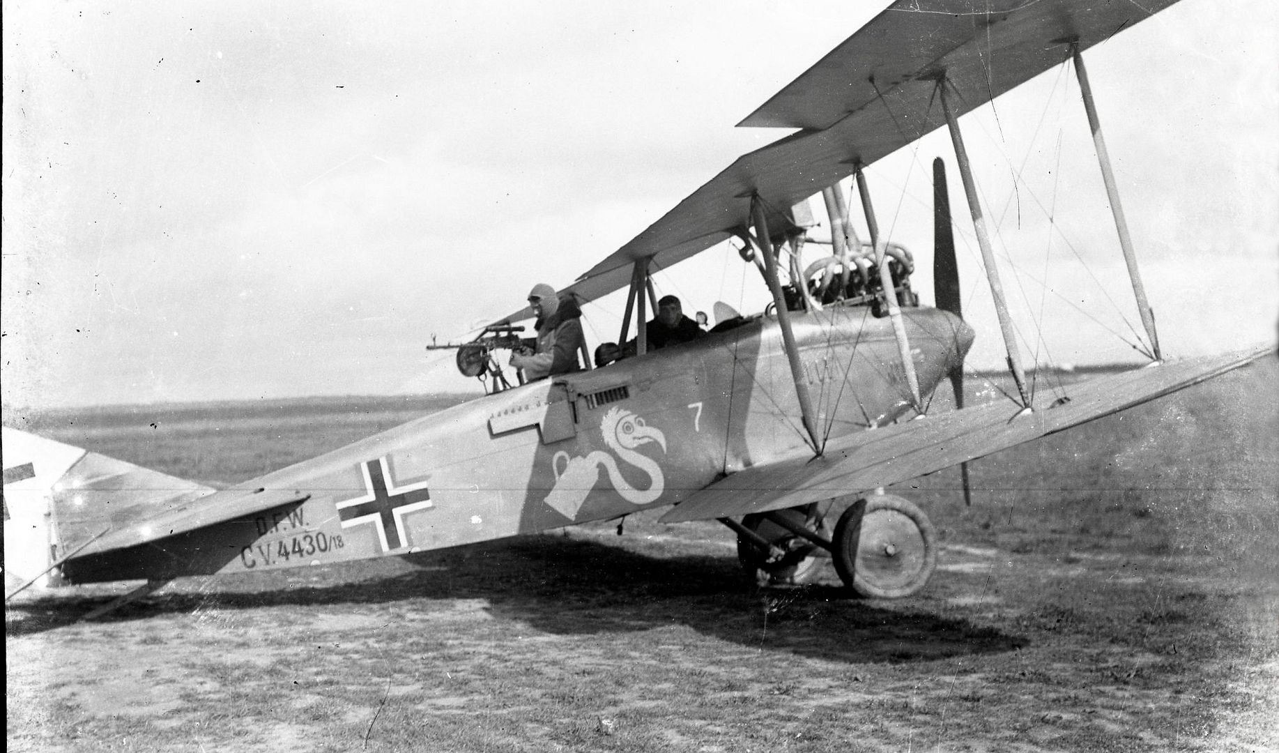

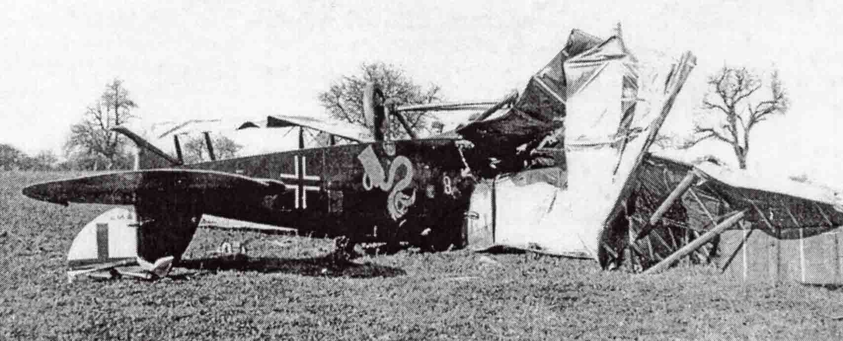

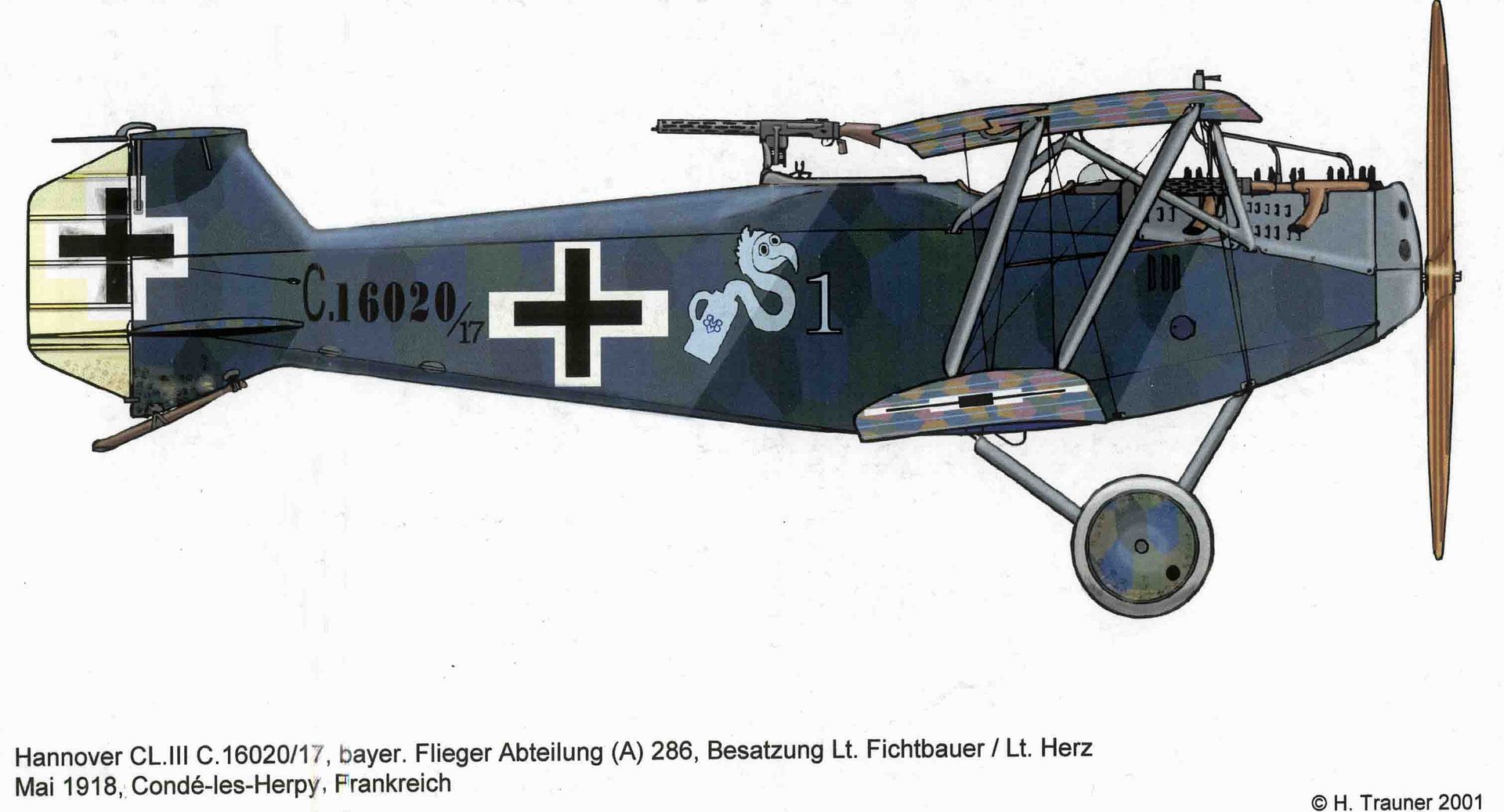

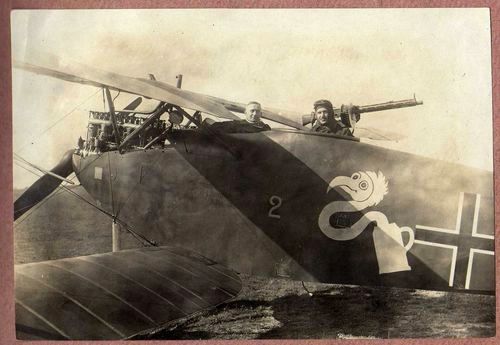

Well, it is known that in 1918, FA 286(A)b had a mix of aircraft types, typical of most Flieger Abteilungen. This unit has become fairly well-known in recent years, due to their unusual and distinctive unit insignia. Bavarian air service historian Reinhard Kastner presented an excellent article oin the markings of the unit in "Proepplerblatt" Nr. 1, Summer 2001. In 1918, photos show that the unit had DFW C.V's, as well as Hannover CL types and later, LVG C.VI's. 15 July 1918 might be a bit early for the LVG C.VI, but not impossible; there were 173 of the type recorded in the Frontbestand listing on 30 June 1918; rwo months later there were 400.
Here is a DFW C.V of FA 286 (A)b.
This is a superb profile of a Hannover, by Hans Trauner, from the aforementioned Propellerblatt issue.
A crashed LVG C.VI of the unit.
And a Hannover.
