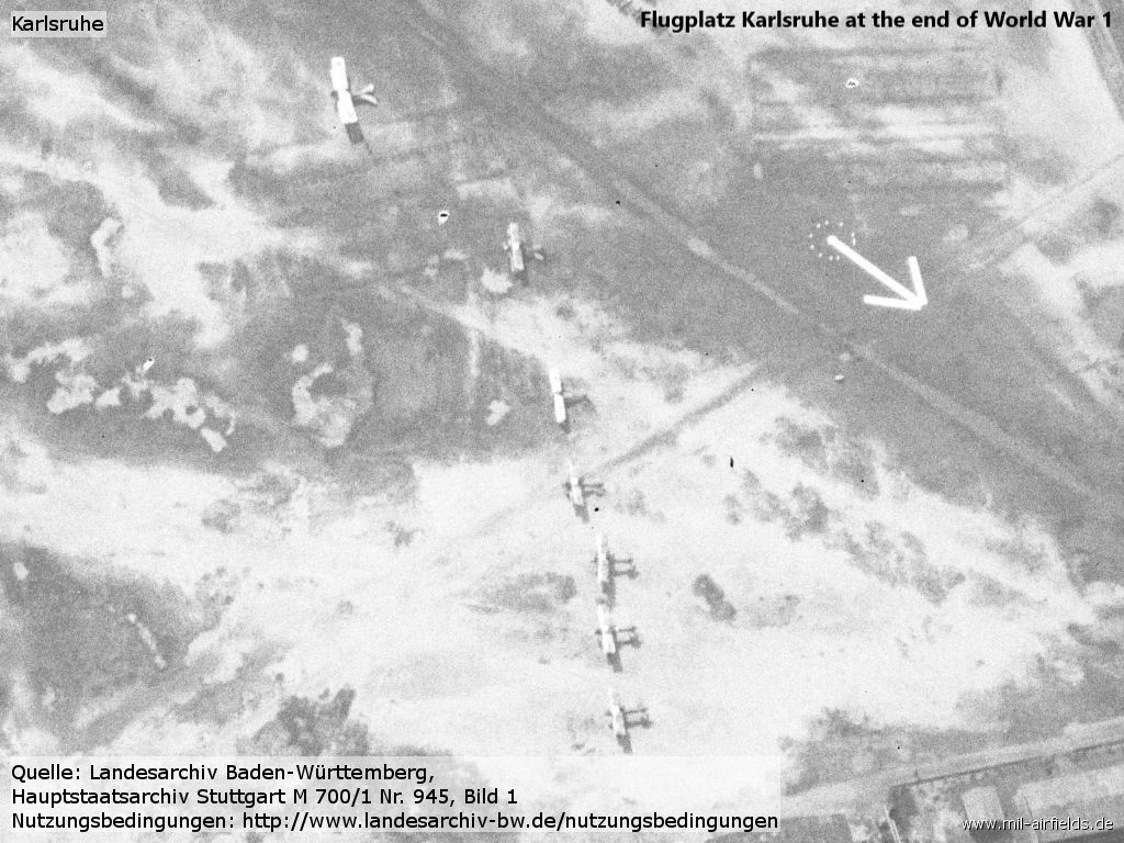

Koflheim. 26-08-1918
On 26-08-1918 (sic, has to be 26-06-1918) Leutnant der Reserve (Willy) Rosenstein also shot down 1 D.H. 4. Since 01-03-1918 the whole Staffel is mobile.
