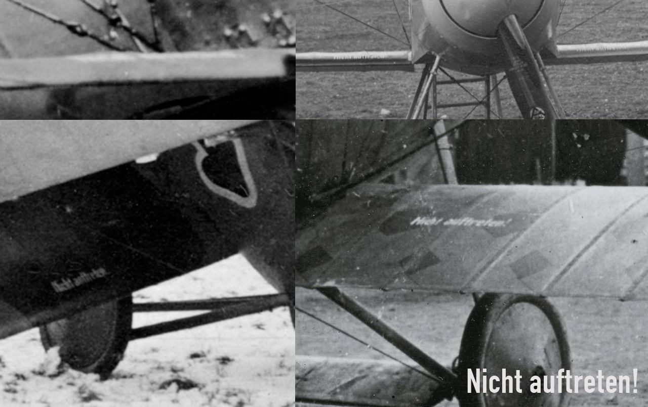

Wing warning markings on Albatros D5
I am trying to locate where the marking "Nicht betreten!" is located on Albatros DV and DVa wings. I need to find the correct placement on my 1/3 scale JW aircraft. Thanks

The German term "Nicht betreten!" in this case simply means "Do not step (on)!".
It gives no further explanation, but in this case the surface or structure is not suitable for carrying (heavy) loads. (Modern) pictograms were not used very much in those times. Their widespread use started shortly before WW2.

Some Albatros D's have painted it on front of the under wing, near fuselage. It was written because mechanics during making maintenance near engine use under wing as a step (like it was possible at other early aircraft). Albatros don't have step place at this point.

A Picture is worth a thousand words. Thank You sir!!!
