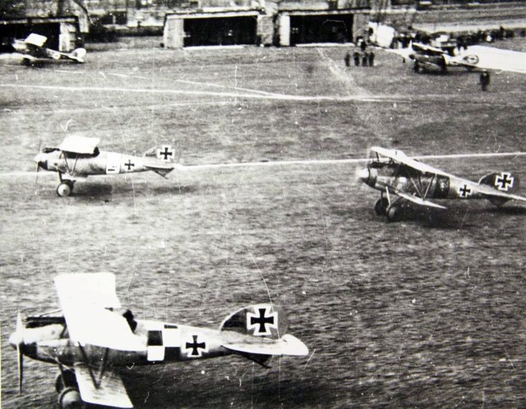

Many years ago, Alex Imrie first stated the the Albatros D.Va 5426/17 seen in this take-off photo of MFJ I at Aertrycke was flown by Gotthard Sachsenberg.

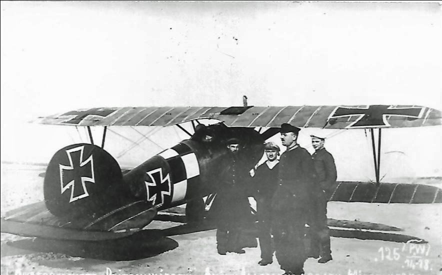

However, that was a long time after 28 May 1917. The photos of Sachsenberg's D.Va all likely date from the Spring of 1918, such as this one, with Sachsenberg himself under the 'XX' mark.
And as here:
In May of 1917, Sachsenberg would have been flying an Albatros D.III, and I don't know if he used a similar checkerboard marking on any of his D.III's. I've only seen one rare photo of Sachsenberg posing with a D.III, and it seems to have been in a factory finish. Other Naval pilots in MFJ I and later MFJ II also used checkerboard markings.
This D.III in flight is said to be a Marine Feld Jasta aircraft, but that's all I know; I sincerely doubt that it was flown by Sachsenberg.
If I were you, I'd be very cautious about attributing the reported 'single seat scout with a chequered design' to any particular unit or pilot, beyond perhaps a cautious statement that it may have come from MFJ I - based on the location more than anything else.
