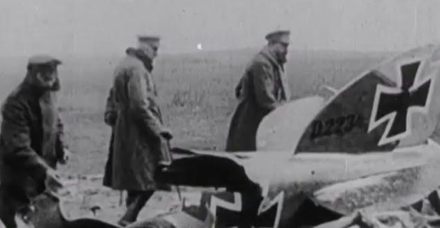

This is another in the Ted Walshe series that he has posted to YouTube this week. What will attract the attention of members here at the Aerodrome is to figure out who was in these two aircraft:
  • Allied? 41592 at t=1:43
  • German D2234 at 5:08
In the first clip it appears as if the Observer is standing in 41592, but oddly no other markings. Is the paint job on the tail a clue?

Allied plane is US, I think DH-4. Picture showing US markings on top wing with similar side markings.
https://www.thinglink.com/scene/620327701881815040

Ltn d R Roland Nauck was killed in action in Albatros D2234 over Villevegne near St Quentin, 8 April 1917

https://airandspace.si.edu/collectio...ss-jn-4d-jenny
Looks more like a flight of Curtiss JN-4HC's "Jenny" (model corrected)

Its a Curtiss JN-4HC
Serial: 41592
Gunnery trainer aircraft, circa 1921.

Does anyone here know which Squadron the Sopwith Camel @ 2:16 belongs to?
Better yet, The Pilot's identity?
Just curious.

The white triangle is the 148th aero squadron. They flew Camels in late 1918
