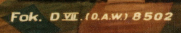

Hey folks. Could use some pointers.
Browsing the Paul R. Stockton album on the National Air and Space Museum site and came across this Fokker D.VII Werke number (O.A.W) 6458. You can view it here:
http://edan.si.edu/slideshow/slidesh...X-0283/9A11573
Go to page 13 and select the third thumbnail.
The caption states it was shot down by a Lt. in the 12th Aero but does not mention the Lt's name.
The 12th had three confirmed aerial victories during the war and a few unconfirmed. Working on the assumption, possession of physical evidence would result in a confirmed kill I am ruling out all but the three confirmed. (big assumption I know).
If so then it was likely forced down on the 28th of July by Lt. Stephen Thompson (observer) or Lt. Dogan Arthur and Lt. Fleeson on either 12 September or 30 October 1918.
Stockton joined the 12th Aero Squadron on 27 June 1918 and remained with the unit through the end of the war so he would have been present during all three victories.
It's a long shot but I am trying to can pin down to which Jasta this aircraft was assigned.
Additionally, if some one can point me in the direction of a resource I can use to determine which Jastas were stationed where and when I'd really appreciate it.
Finally, has anyone seen or heard of a Fokker with brown and white checkered markings? It was involved in an engagement with Lt. Dogan Arthur during the Meuse Argonne Campaign on 30 October 1918.
Thank you for the help.

Not being an expert but it looks like the mauve and green material from the undercarriage wing. presumably the writing was added later

Note that, despite the many illustrations and replicas featuring it, no Fokker D.VII undercarriage axle wings were covered in lozenge fabric in WW1 (that I have ever seen evidence for).
This fabric is from an aileron or tailplane component.
Fokker D.VII (OAW) 6441/18 served with Jasta 62 and 6467/18 served with Jasta 71 but this does not help you with 6458/18 other than to confirm that it was from within a group of numbers that were actually issued to units and not an aircraft finished post war. Possibly it could have come from one of those units.

Just because Stockton labeled the piece of Flugzeugstoff (aircraft printed camouflage fabric, from Fokker D.VII 6458/18) as coming from a Fokker downed by a 12th Aero Squadron Lt., doesn't necessarily mean that it actually did. And I'm not intending to cast aspersions on Stockton, who was obviously a brave, dedicated and resourceful officer.
However, I think it's just as likely that this piece was 'souvenired' from a D.VII that was found after the war. The 12th Aero Squadron was based in Trier during the occupation in 1919, on the big field near the Zeppelin shed - as photos in the album show. There were 90-some German aircraft in that shed, many of them D.VIIs.
These aircraft, and others abandoned by the Germans, provided lots of opportunities for scavenging souvenirs. I have seen several other fabric pieces taken from surrendered aircraft post-war that were labeled as having been "shot down in combat" by so-and-so.
Also, it seems to me that Stockton added some of the captions to this album years after the war, and maybe his memory wasn't always spot on..Why didn't he mention the name of the "Lt." who shot down the Fokker? Maybe he didn't remember it or other details about how he acquired the piece.
There's another piece of lozenge fabric in the album, with a large "2" painted on it.
The style of the "2" looks like this piece might have come from an Albatros-built D.VII.
I'm just being my usual skeptical self, and not trying to offend anyone. Trying to match this fabric piece with one of the three confirmed victories scored by 12th Aero crews might be a futile endeavor, for any number of reasons. Trying to match any Allied victory claim with a specific German loss is always fraught with difficulty as many threads and posts on this forum will confirm. Many American confirmations were, frankly, based on less than solid evidence. Also, even if a German plane was "shot down", it may have made a forced landing or even a crash landing that the pilot or crew survived, and thus little or no German records survive of that particular incident.
Again, I'm not attempting to impugn the memory or reputation of Paul R.Stockton or of the valiant crews of the 12th Aero Sqdn. In fact, Alan Toelle and I produced an article about the Salmsons of the 1st and 12th Aero that was published in Over the Front several years ago.
By the way, in regard to Dogan Arthur's description of a Fokker with "brown and white checkered markings"...This may simply have been a hurried impression of glimpses of the printed "lozenge" camouflage fabric, made in the heat of combat. I've seen a number of American combat reports describing "checkered" markings of various colors on Fokkers, and I think many of them resulted from lozenge fabric. However, some Jagdstaffeln did indeed feature checkerboard markings as unit or individual insignia.
Good luck with your research.

Daniel - Greg's right on the money with his observations. I've seen lots of albums with erroneous captions, missed dates, etc. So a little skepticism is a healthy thing.
Maybe we'll be able to match that serial to a known Fokker at Trier at some point to answer the question, but given Stocktons artistic ability, can we first measure the height of the characters in the serial number and see if this strip was in fact cut from that Fokker or if he painted in a serial later on a strip to include in the album ? The serial looks a little small to be from the side panel of the airplane to me - maybe a stencil from elsewhere ?
I'll see what I can find - Maybe Chuck Thoms here on the 'drome who has documented a few of the Trier Fokkers - will know something about that particular machine.

To quote Mike: "The serial looks a little small to be from the side panel of the airplane to me - maybe a stencil from elsewhere ?"
Absolutely. As rsanz said, this piece of fabric with the "Fok. DVII. (O.A.W.) 6458" stenciling comes from either an aileron or the tailplane/horizontal stabilizer, or the elevators. Each of those components on OAW-built D.VIIs had the military serial number stenciled on in small white characters.
Here's an example from the underside of the starboard aileron of the famous Knowlton Fokker D.VII in Canada:
Even though the fuselage of this famous (and very original) D.VII is Albatros-built 6810/18, the ailerons, upper wing, tailplane and elevators all come from other OAW-built D.VIIs.
