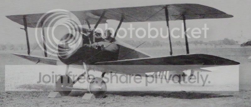

Wingnut Wings offers an option for white rimmed cockade parts for the lower wing ailerons of Barker's Camel B6313. I guess the interpretation is based on this photo. Do you folks buy it? I think the interpretation is wrong.
Yours Mikko

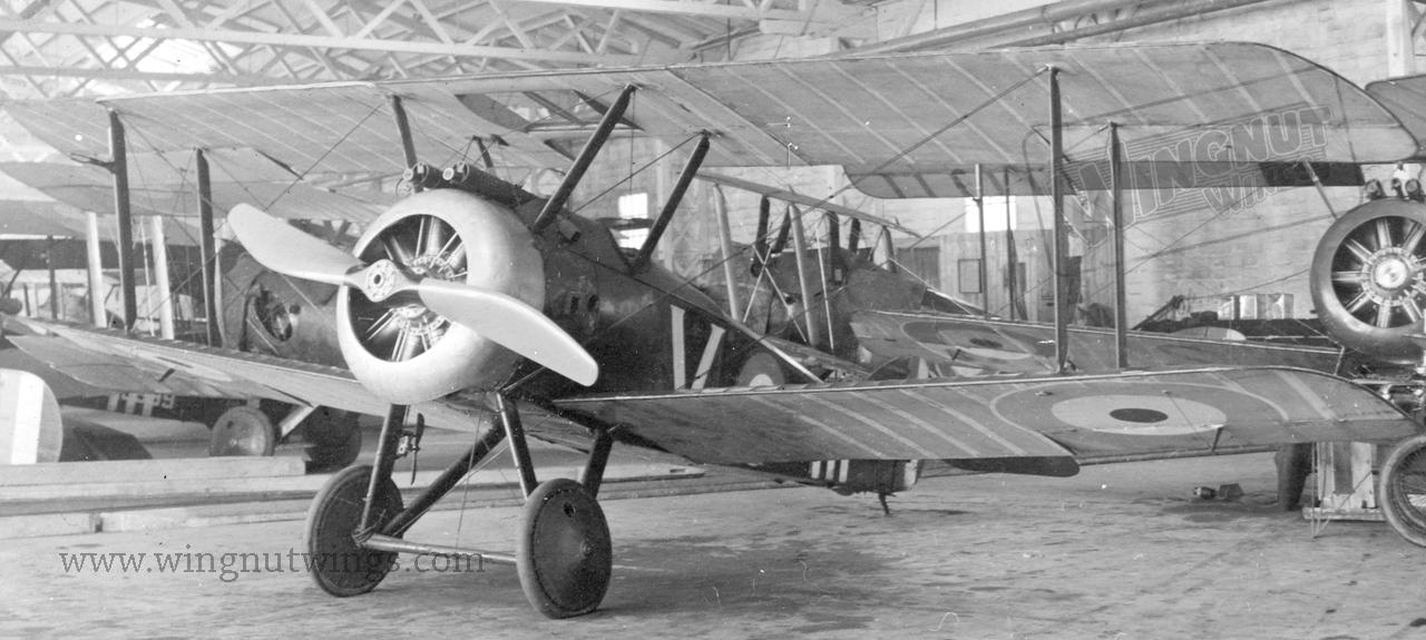

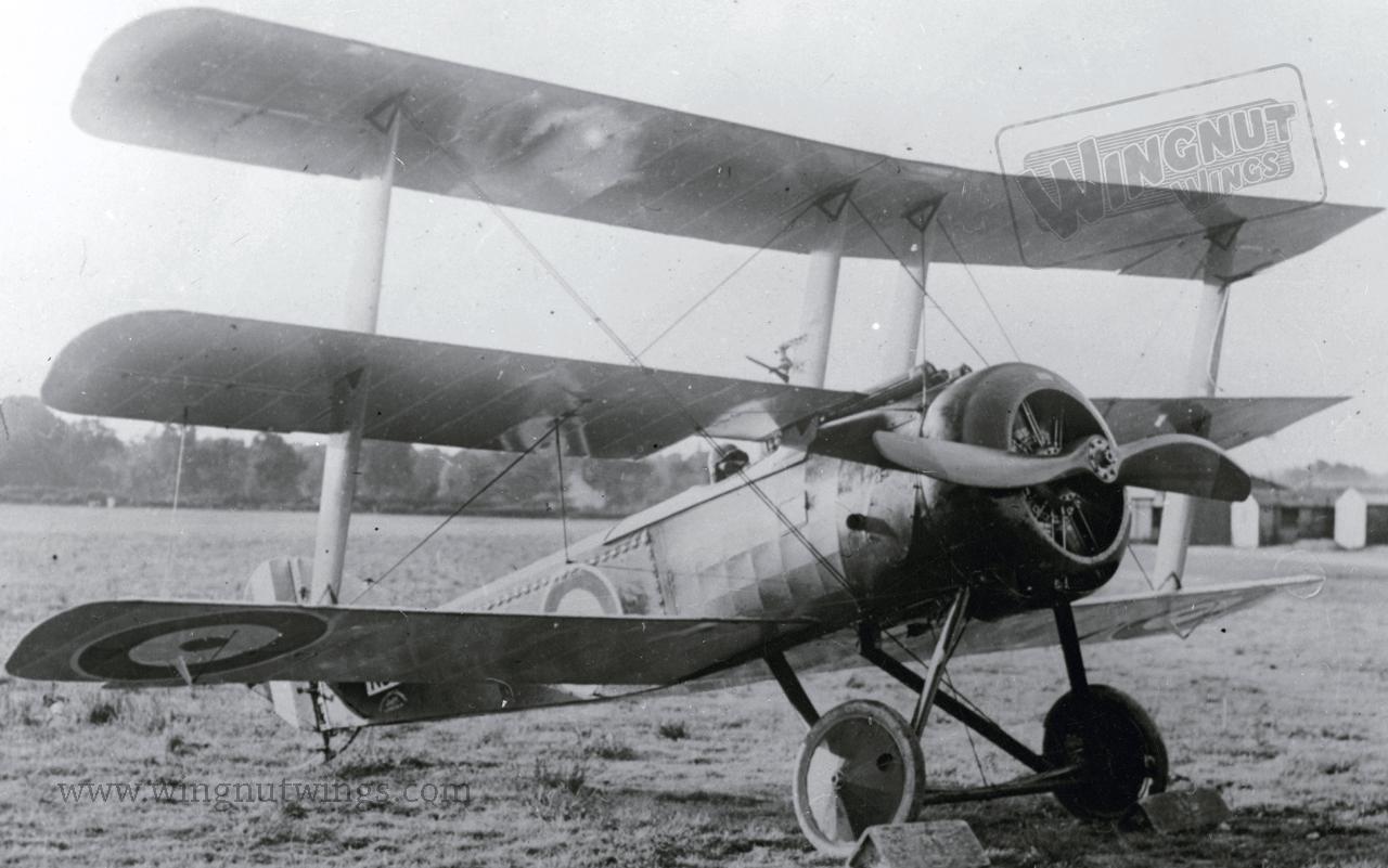

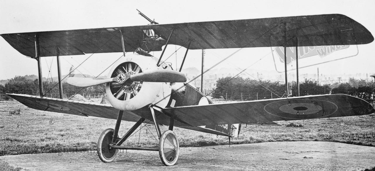

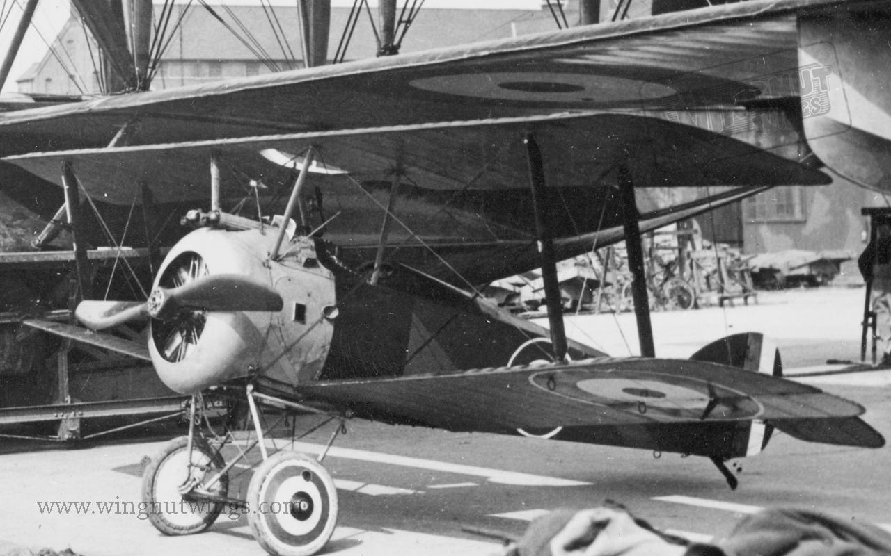

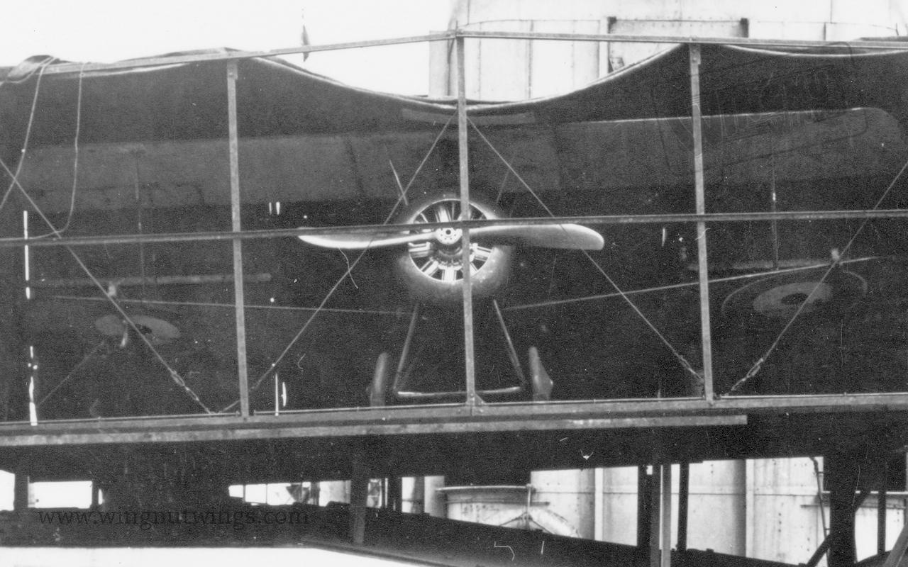

While others with an interest in how nuanced these things can be might "...immediately confirm that the cockades on the lower wing surfaces were..." sometimes outlined in white on Sopwith Camels (and many other British aircraft), depending on the manufacturer and production batch.
Compare the photos of Barker's B6313 in Chaz Bower's "Sopwith Camel - King of Combat" on pages 55 (28 Squadron with original "no outline" aileron cockade) and 58 (139 Squadron with replacement "white outline" aileron).
Camel wings and ailerons were quite often swapped around between different aircraft (photos obviously does not show Barker's B6313)...
A few other examples of white outlines applied at the manufacturer's whim...

I do not have the book, but I believe you. Photos printed in books are usually clearer than odd internet pics (Kagero books are an exception!). So I will use the white lined cockade part decal at least for the port side aileron!
Thanks!
Mikko
