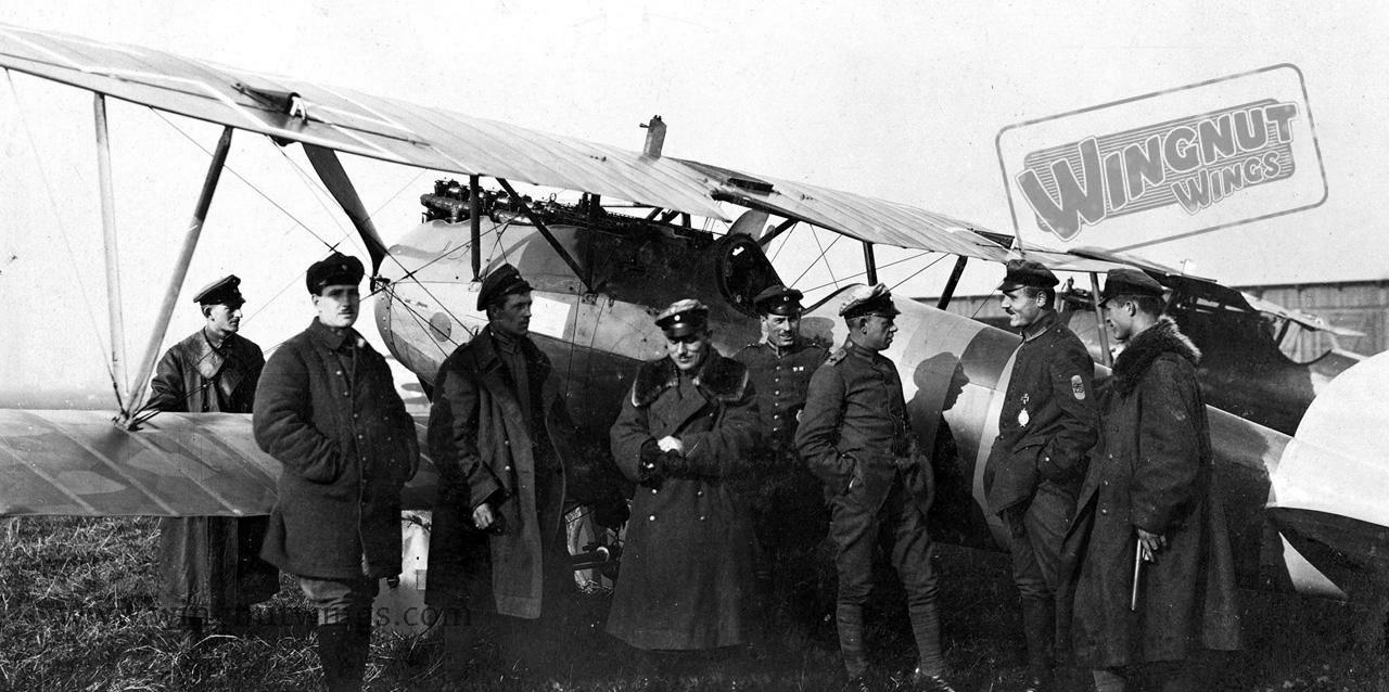

A Jasta 25 line up with two D.V-s the foreground one is uprated (three lines table):

Note that other photos of this same aircraft show that it has an early 160hp Daimler-Mercedes D.III with the tall thin air pump mounted at the rear of the engine. So it is not 'uprated', if anything it is downrated. Also it does not have a propeller spinner, but a rounded nose fairing similar to those seen on later OEF D.III. It may be undergoing some sort of trial.
The increasing weights shown on the weight tables appear to have nothing to do with the engine. They seam to refer to the increased weight due to the strengthened airframe.
