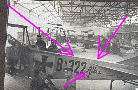

Württemberg air Units Markings ALB???
Hi
i have here a photo from a aircraft of the Württemberg FEA unit but i don' t know how unit. To see a big 'B' then II and 322/14 in cursiv Alb.(Kon.)
Have any more infos...

Hello Thommy,
It sounds like an Albatros B.II.
Alb.B.II 322/14 (built by KONDOR).
That is the best that I can figure without a photo and the limited resources that I have.
Best Wishes, Jay

Hi Thommy,
Württemberg had only one FEA.
Fliegerersatz-Abteilung 10 at Böblingen formed on 19.05.1915.
Regards Alex

here a photo...

Hello Thommy,
Thanks for sharing the great foto with us.
I can't add anything more to what I have already commented on.
Hopefully someone will either agree or disagree with me and add more information to this.

Many thanks what means the 's' on this aircraft perhaps school unit???
That makes sense to me as there is also an "S" on the fuselage on the next plane. With everyone gathered around the front machine it does give the impression of a schule.
The next machine is a different make and model. The rudder to the right side appears to be another Albatros B.II.

There is a more certain attribute that confirms that this photo is taken at a Flieger Schule... namely, right under the tail it clearly gives the name of the Flieger-schule, which confirms it to be Boeblingen.
